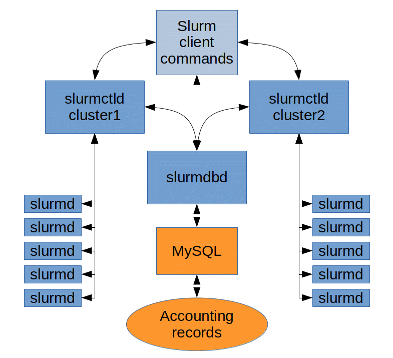

Below is a diagram of a fairly typical cluster, with slurmctld and slurmdbd on separate machines. In smaller clusters, MySQL can run on the same machine as the slurmdbd, but in most cases it is preferable to have it run on a dedicated machine. slurmd runs on the compute nodes and the client commands can be installed and run from machines of your choosing.
Typical configuration

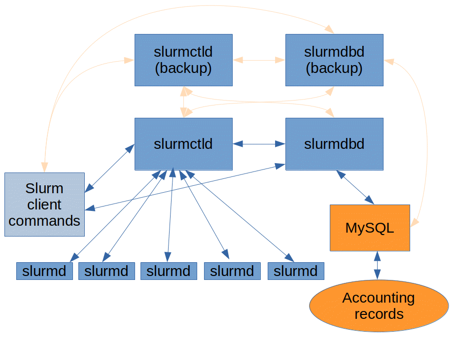

Communication with multiple controllers
You can configure a secondary slurmctld and/or slurmdbd to serve as a fallback if the primary should go down. The ports involved don't change, but there are additional communication paths that need to be taken into consideration. The client commands need to be able to reach both machines running slurmctld as well as both machines running slurmdbd. Both instances of slurmctld need to be able to reach both instances of slurmdbd and each slurmdbd needs to be able to reach the MySQL server.
Fallback slurmctld and slurmdbd
Communication with multiple clusters
In environments where multiple slurmctld instances share the same slurmdbd you can configure each cluster to stand on their own and allow users to specify a cluster to submit their jobs to. Ports used by the different daemons don't change, but all instances of slurmctld need to be able to communicate with the same instance of slurmdbd. You can read more about multi cluster configurations in the Multi-Cluster Operation documentation.
Multi-Cluster configuration

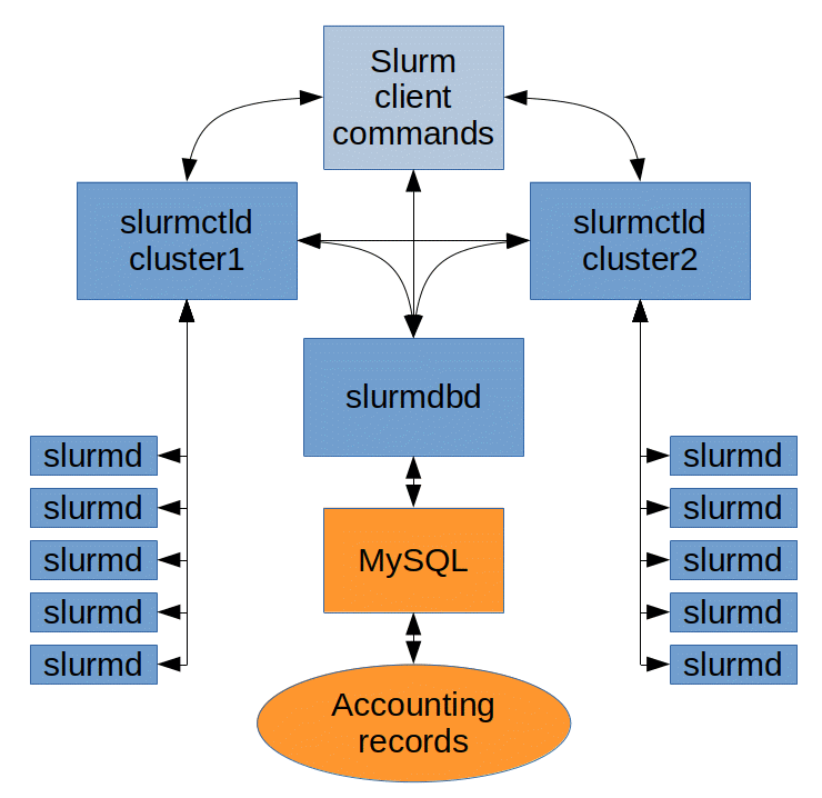

Communication in a federation
Slurm also provides the ability to schedule jobs in a peer-to-peer fashion between multiple clusters, allowing jobs to run on the cluster that has available resources first. The difference in communication needs between this and a multi-cluster configuration is that the two instances of slurmctld need to be able to communicate with each other. There are more details about using a Federation in the documentation.
Federation configuration
